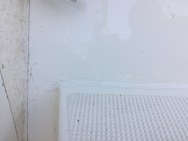

Hi -
I noticed last week that my 2006 22 Cruiser has some spider cracks on the starboard side of the cockpit. Any idea on the reason for the cracks? Can someone share with me the best way to fix and prevent future cracks?

These are called "stress cracks"--although they are not really due to "stress". the gel coat is laid on thick in these areas, to make them smooth, but not much fiberglass mat backing, because of the sharp angles in the mold.
Either live with them, or take a Dremel tool, with a sharp point bit, and "V" them out. Fill with Gel coat, and then polish. May come back--but may not--and you will be happy in the mean time. Good way to learn to do some gel coating work.
Biggest problem is matching the tint. Spectrum Color has in the past had the C Dory white 00-10 in the recent past, it has been only available in quart sizes, but appears they have it in the patch kit. Since Gel coat goes bad with age, that may not be practical. A little yellow, brown and black pigment---very very little, will do the job with "white".

There is flex going on in the area of the spider cracks, otherwise it would not have cracked. As indicated, it is generally a cosmetic thing not a structural need.
As indicated, typically the gel coat had been applied to thick. Gelcoat is not structural. The crack will reappear.
The proper repair is to grind down into the laminate with a tapered hole, build up the laminate, then spray on the color matched gel coat. This is typically more than the home do-it yourselfer is wanting to tackle. The color matching and gelcoat spraying takes some practice. But once you know how, all small repairs become rather easy. I have been playing with fiberglass for years, I own no jars of paste.
Not necessarily I have seen these spider like cracks on many boats in areas which do not flex.
There are a number of ways to "fix" this..one is to completely grind off all of the gel coat in that area, and either build up with another layer of mat, smooth, fill, and then gel coat. To try and put small number of strands and or pieces of mat in this type of repair is difficult at the best. The simple "V" technique with paste works as well as anything, short of semi rebuilding the area for this specific type of repair, especially for a novice.
Fair enough, I have been working with fiberglass since 1952, (65 years) and I have used paste in some repairs--but I don't keep old paste or gel coat lying around. [/quote]

Just so I understand, can you guys confirm that these cracks are not structural and will not allow water ingress into the core? I've seen them on other boats and it's a good thing to know if one is shopping for a boat.
Posts: 21535
PostPosted: Mon Sep 18, 2017 7:19 pm    Post subject: Reply with quote
Generally this is correct. It depends on where the cracks are, and what caused them. If they are on the transom, I look a bit more carefully at what is going one. If they are over an area which is cored--again I am more concerned. In a curve like this--where they are very common--not a worry.
Some impacts can also give similar cracks. If so, then you may want to look at the laminate under the area. This is where a simple moisture meter may be a big help---even the cheapie from Home Depot. If the rest of the laminate is dry--and one area under a crack, then more remediation may be necessary. None of these are fatal wounds however.

Thank you to all of you for your wise advise. I think the repairs are beyond my skill level at this point in time. I will leave it as it is for now while I look for some "how to" videos in YouTube and read some "how to" articles.

Sounds like you're passing on it, but this is pretty much your scenario.
https://youtu.be/339W-ZNC1_0

Looks like what I suggested.

Use the point of a can opener and score along the spider webs (tracing ). Clean well and build up with gel coat as others have mentioned.
