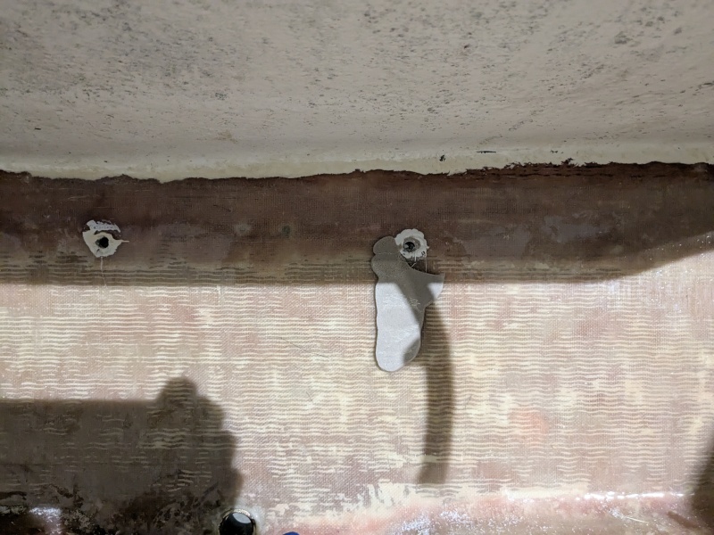

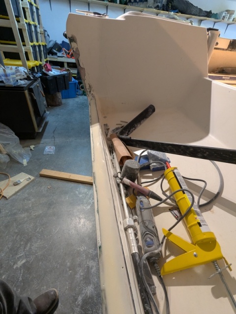

Next, I redrilled the bolt holes for the main outboard and kicker bracket in the new inner transom skin.

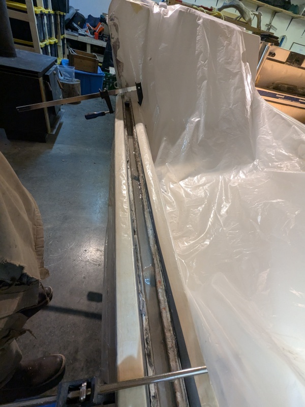

I made up some jigs to clamp the transom to uniform thickness from the outside (bearing against the 1" spacer pucks). Two 2x10 planks on the outer transom, one 2x10 inside below the splashwell, and 1 2x4 inside above the splashwell. I used the outboard and kicker bracket bolt holes to fix the planks in place, using bolts I'd warmed up and applied a layer of candle wax to (to enable their removal later once the CarbonBond had set up).
The bolts I used were smaller diameter than the holes - to prevent CarbonBond from leaking, I applied a ring of 4200 around each bolt hole before clamping down the planks.
I added compressing force to the bottom of the lower inside plank with 2x4s bearing against a 2x10 abutting the cabin wall.
Last step was to fabricate a funnel to ensure easy pouring, with some stops allowing it to sit in place hands-free.

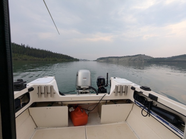

Everything reassembled and cleaned up, it was time for a test run. I'd performed some concurrent repairs on the Honda BF90A3 main motor (replacing a corroded tilt tube, and installing new oil seals on the upper end of the gearcase) which needed assessment as well.
Everything worked as it should; the motor motored, and the transom transomed. Externally a pretty anticlimactic result, but at least I (and now some of you) know what went into regaining normal function.

A lot of work (much of it late nights that would have otherwise been occupied by sleep), but immediately rewarding in that it enabled our planned mid-June SE AK family trip to run as planned.
