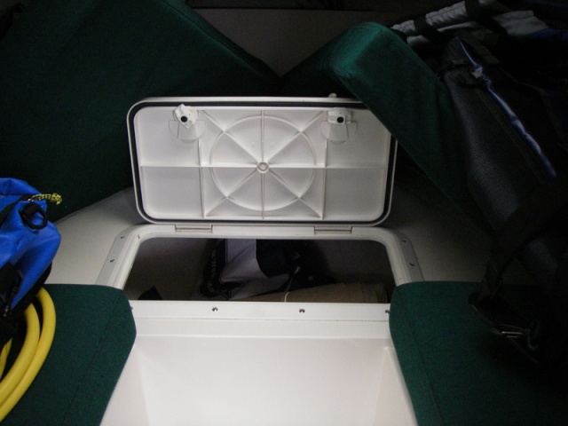

I posted some pictures on page 9 of my album that shows what the CD 19 has for storage under the V-berth. I had the cushion split so I could access the hatch easier. Why they have not added this storage area to the 22 is a mystery to me. The requirement for floatation is much greater for a boat less than 20 feet than for on larger. [img]
