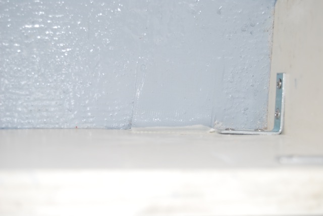

I agree that there is no worry from a brief immersion. In the long run it is best to have the screws better sealed. The best is drill out, slightly undercut, and then drill new pilot hole, and put in the old screw. Several issues here. Most of the boats had cadmium pated "L" brackets and screws--which rust easily. You do have the vulnerability of screws.
The easiest thing to do, is to pull the screw, eliminate the "L" bracket and screws from the wood also. drill out the hole enough to fill with epoxy, and then over this area, put a tab of fiberglass cloth and epoxy. You have eliminated the screw in the hull, the hole in the hull, and the "L" bracket.
The down side of this, is it might be slightly more difficult to remove this tab if you want to rebuild the cabinets. I don't see this as an issue. The epoxy/cloth (I used some triaxial cloth I had in stock), takes a very short time--have to sand the area where you are putting the tab, and be sure it is clean. Do every other tab at first, or do some tabs between the "L" brackets, and then pull the screws, and tape over them--so there is no chance of the cabinet moving.

I agree that it's best not to have screws going straight into the structural hull core with no protection. Granted, it's not a place that is likely to "soak" in water, but I just find it to be something I don't want to worry about (so I changed mine).
One thought if you are going to tab: As Thataway said, it can make it a pain to remove any cabinetry. Not that you are going to do that every day, but why remove the option ('course you could always cut tabbing, but...). Also, I'd be a bit "meh" on the idea of bonding tabbing to the top (white) surface of the Decragard (you could cut away the top layer, but that's more work again). So if I were going to tab (and I may in some places), I think I would do it how I have seen it done on Albin boats (just for one example). Essentially, you lay up the tab and bond it properly to the hull (sole) as you would normally tab. But, you don't bond it to the "furniture." Instead you lay it up against the furniture, but keep it from bonding (tape, wax, etc.). So you end up with a "fin" of tabbing. Then you screw that to the furniture (which is not structural anyway). As such there is no worry about bonding to Decraguard, and things are removable/replaceable by undoing the screws (yet there is no penetration into the core).

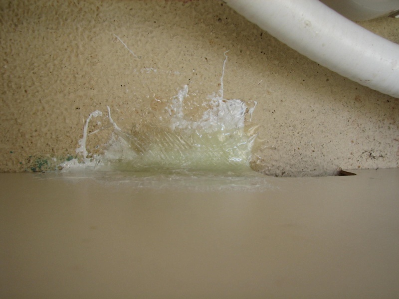

I did something a little different (and less messy). It was a bit of an experiment, and if it doesn't work out, I can easily go to one of two "Plan B's" with no more work than I would have had originally. What I did was buy slightly larger, stainless steel angles (instead of the mild steel ones that were there). I removed the original angles, overdrilled and filled the holes into the core, and chiseled them off flat when in the green stage. Then I bonded the new angles to the sole with thickened epoxy. After that had cured I screwed their upper legs to the cabinetry.
The place I think that might conceivably fail is in the bond to the sole. If that does happen I will move to one of two "Plan B's." One would be to screw them to the sole into the epoxy plugs; or two would be to remove them and do tabbing as described above. Either of those would eclipse any "failure" of the way I did it already (and again, not structural). So far so good with Plan A, but it's early days yet.

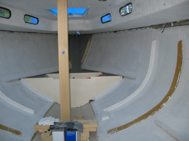

I figured I'd post a photo of what Lost Petrel and I are referring to. This is an Albin Vega (sailboat, but they did this in powerboats they built as well), with the bulkheads out, but the tabbing "fins" still in place. (One happens to be white and one natural "glass" gold color). When the bulkheads go in, they are set flush to the "fins" and then screws go through the fins and into the bulkhead (or furniture).
This is arguably not as strong as full tabbing (fiberglassing to both surfaces), but it seems to have held up pretty well in these structural bulkheads, so in non-structural applications it should be completely fine, in my opinion. Just another way to do things.
In my case if I were going to make some of these "fins" of tabbing in my C-Dory (in place of the metal brackets), I would likely do something like put clear packing tape on the furniture (where the tab would land) and prep the hull for fiberglassing as per usual, then "tab" to the hull and up onto the clear tape. Once the glass had cured I'd loosen the furniture piece in question and pull the tape, then screw the remaining "fin" of tabbing to the furniture (as the angle brackets are) once it had fully cured. It's one way to tab the furniture in place but also keep it reasonably easily removable, if one so desires. Just one way of course, and simply a choice.

Too late to edit, but I should have mentioned I wouldn't make such comprehensive (long) tab "fins" as in the photo to fasten non-structural cabinetry/furniture in a C-Dory. Just short tab sections would be plenty, in my opinion. Those in the photo are for structural bulkheads, whereas the C-Dory furniture is basically "being held in place."
