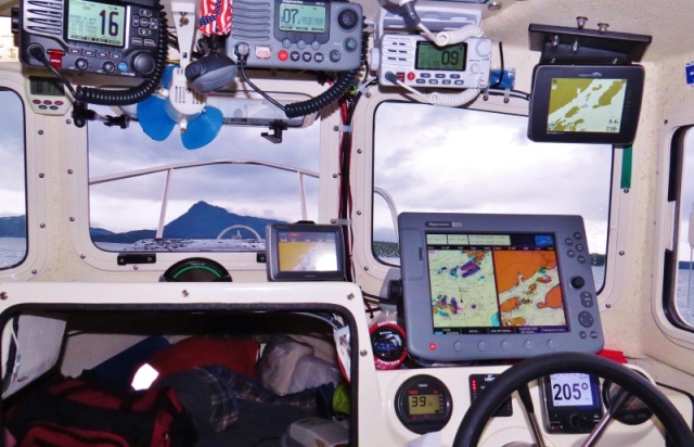

Wondering how many here have made the switch from the old Raymarine C series (80 or 120) to the Axium? And if you went with the Pro or the Plus version? And If so, which did you choose? Why? And are you happy with what you got? Would you do the same switch again? If not, why not?
I am at the point of needing to make that decision and I see both pros and cons for each way so I’m looking to learn from others experience here. I am going to update the radar to the digital 2K, and the sounder, but that isn’t solid set yet either. Down and sidescan will require a new transducer to get the High Def bottom picture. How much better is that than the old transducer?
My current system is functioning well, with only very rare hiccups. I will have those parts for sale after the switch, if anyone is interested.

The things to consider is that the "RealVision" is a definite improvement, combining down and side scan. The Radar is send via Wifi and will work with all about the same.
The Axiom plus is going to have a significantly faster processor, and to keep it from being obsolete, I would go that way for future updates.
I had a 9" touch screen and a 7" hybrid touch and dial/button. In heavy weather it is easier to use the dial/button method, vs the touch. In the 25, there was just enough room to put the 9" touch and then 7" hybrid (about the same size over all as the 9" touch) in front of the helm. Not sure if there is enough room in the 22 there or not.
Older auto pilot works with new system.

"The Axiom plus is going to have a significantly faster processor, and to keep it from being obsolete, I would go that way for future updates."
Are not the Axium+ and the Axium Pro running the same processor?
I like the availability of the knobs, especially when it is a bumpy ride, so thinking of going with the Pro for that reason. Also, to keep greasy or wet fingers off the screen.
