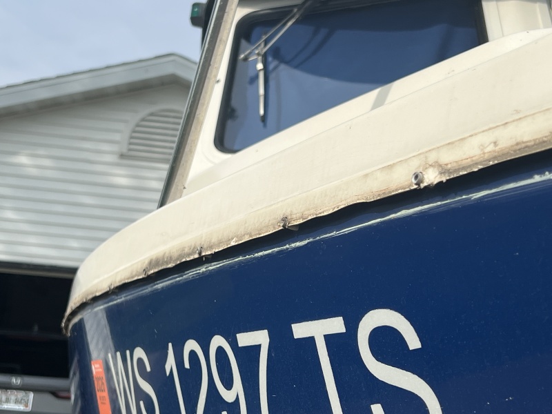

Resurrecting this thread, as it seems to be more recent than the ones from 10 years ago. I had the tailend of my starboard front section of rub railing pop away from the boat last week. This was just about under my forward cleat, or next to the cabin helm. Pulling the rubber insert out, I found that the vast majority of the rivet heads were popped off, so I drilled out the few remaining and pulled the rail off. The only thing holding the railing on, other than about half a dozen rivet heads, was just the rivet bodies. I did see Sunbeam's write up from I think 10 years ago. The material on the inside of the riveted areas in the cabin, is more glass, so I don't think I'll really be trying to hammer the rivets into the boat. Tomorrow I'll plan to drill all the rivets out, from the outside. And probably go all the way thru into the cabin. This section is very easy to access from inside the boat, as it's beside the helm and then along the starboard side in the V-berth. I'm guessing the best repair will be to use ss machine screws and acorn nuts. Or nylon lock nuts. And put a generous amount of sealant on the screws where they go thru the hull. Then again, I kind of like this idea:
I used stainless 3/16 X 3/4 pop rivets with a back up washer on the inside sealed with 5200 when I did mine 12 years back
Any other suggestions or advice appreciated. Colby

Just finished drilling out all the rivets. 29 of them. Didn't want to go the route of grinding down the material inside and pushing the rivet bodies through due to dust cleanup then. Probably going to go the machine screw/washer/nut route, but will decide that based on what is available at the hardware store today. Colby

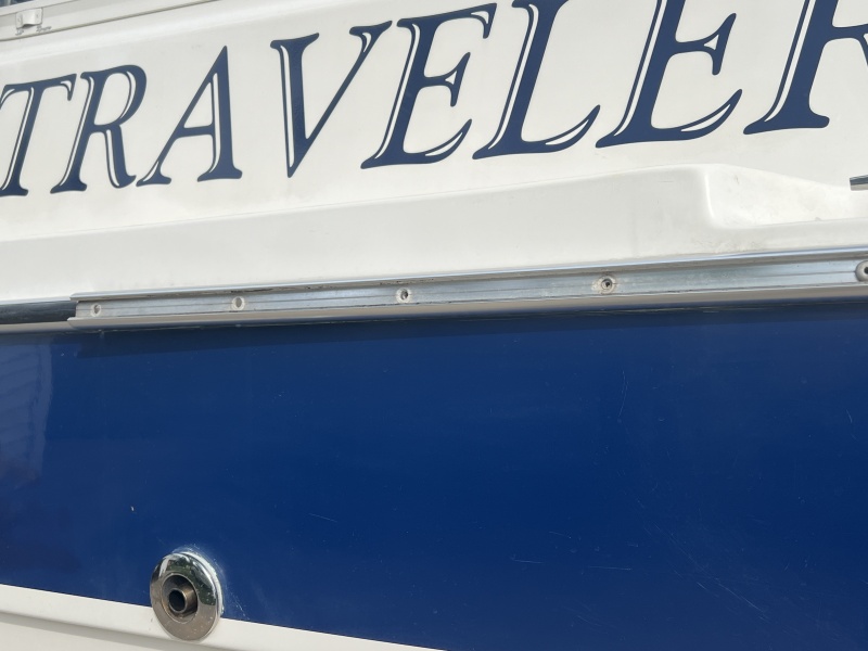

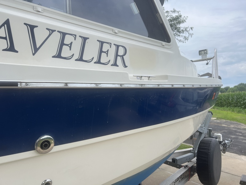

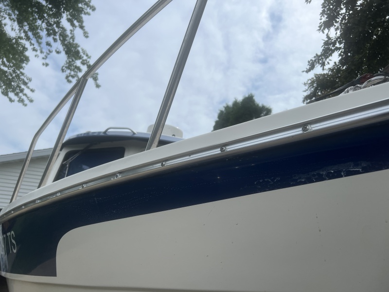

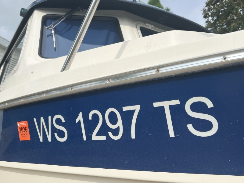

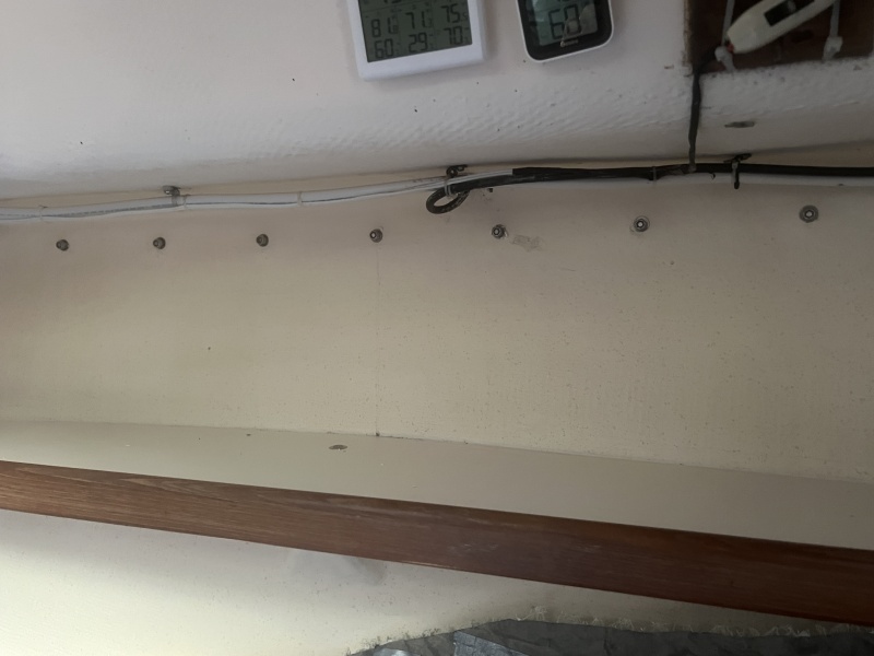

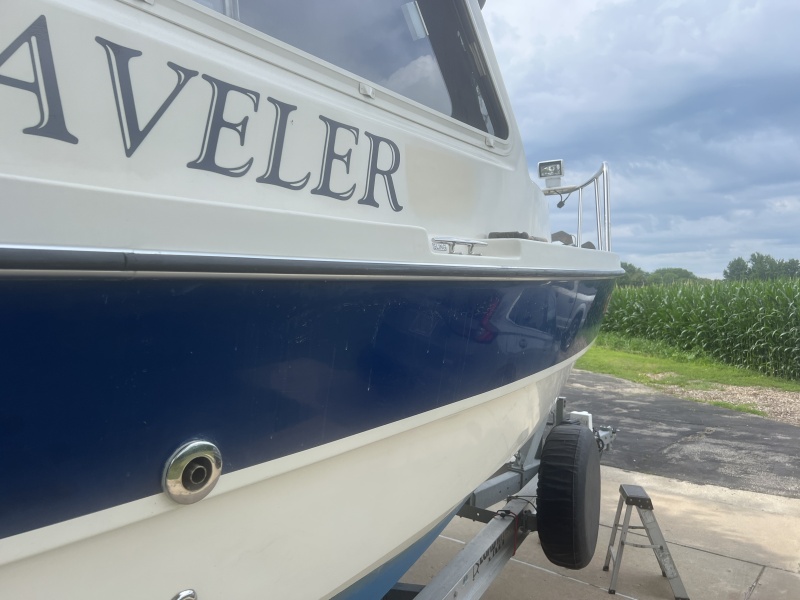

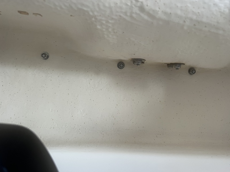

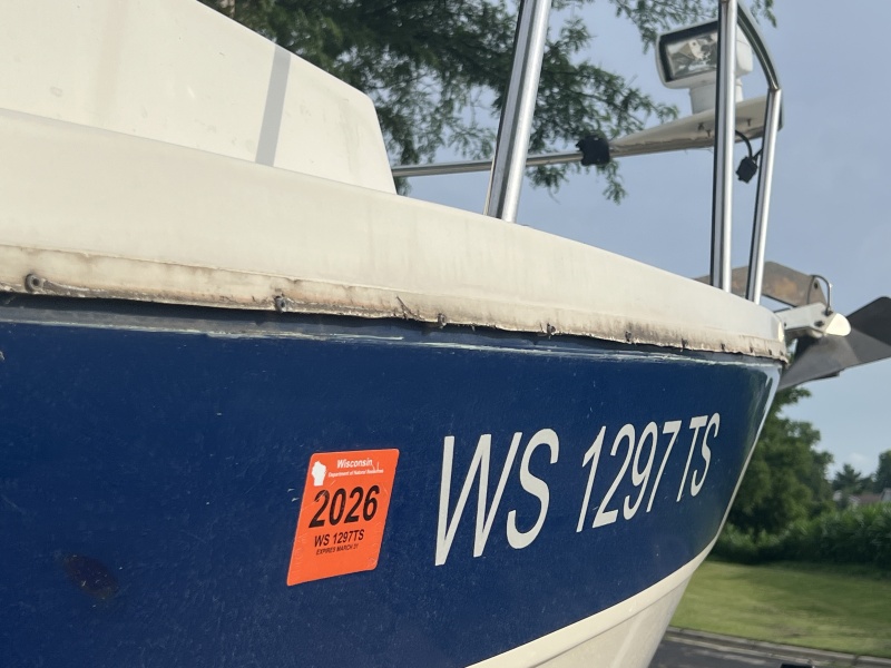

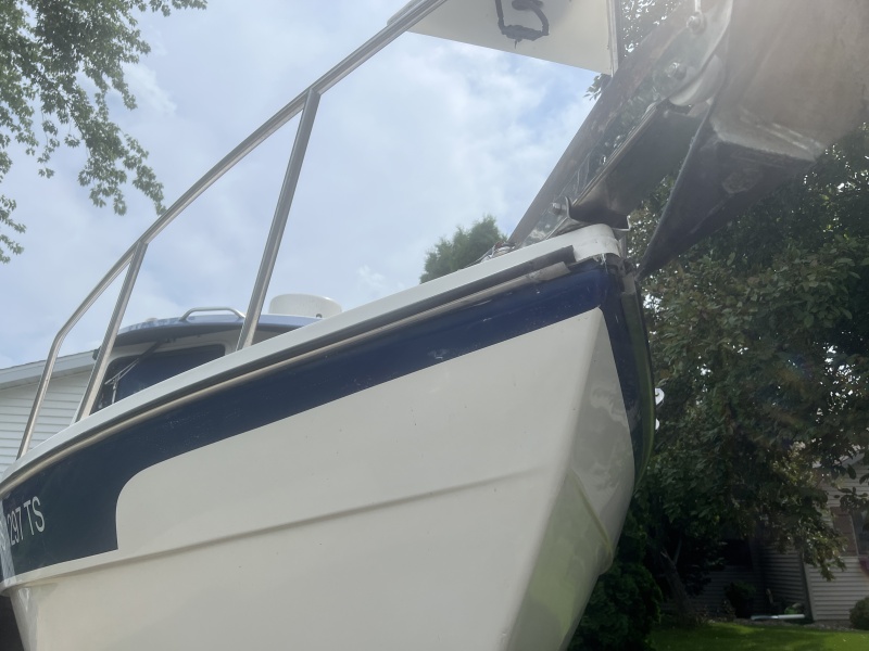

Finished up reinstalling my rubrail today. I ended up using ss machine screws, washers and nylon lock nuts. 1/4 x 20 x 1 1/4". Here's some photos of the job.
First two photos of the rub rail with the rubber insert removed, where you can see the majority of the rivet heads were popped off.
Next two are with the rail completely removed.
I drilled out the rivet bodies, and then used the screws/washers/nuts to reinstall the rail.
Then used a screw driver to slide along the top of the rubber and rail and pushed the rubber back in to the track. The bow cover piece is missing in these photos, but was placed back on.
I used some 4000 sealant I had to seal each screw. Also put a bead in between the two layers of fiberglass (sole and gunnel).
Last two photos of the washers and nuts inside the cabin.
