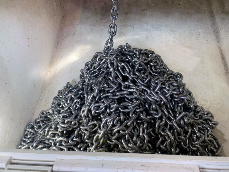

Thanks all for the feedback on my question about switching from rope to an all-chain anchor rode. I purchased 200' of 1/4" high-test from Washington Chain in Seattle. After loading it all into the chain locker, the bow dropped somewhat, but the biggest problem was the factory installed D-ring bolted through the bridge deck/bow. The chain kept piling up on the protruding bolts, then tumbling down into a tangled mess. My solution was to install a 3" PVC pipe with a 45-degree curve to direct the chain to the center of the locker -- it is working like a charm! (Photos in the gallery)

PostPosted: Thu Aug 22, 2024 3:23 pm    Post subject: Reply with quote
Where is your gallery?

PostPosted: Thu Aug 22, 2024 3:45 pm    Post subject: Reply with quote
Hi No Pressure…sorry, I just uploaded the photo.
