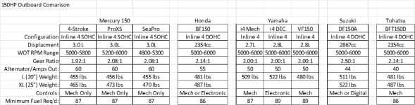

That said, I'm interested in understanding the differences in repower options. The local Suzuki dealer has some huge sales on the 140HP but I'm concerned with under-powering the boat. Interested in the performance differences at 150, 175 and 200Hp. While much of our time will be cruising, we do fish and "get there" so getting up on step is important as well.

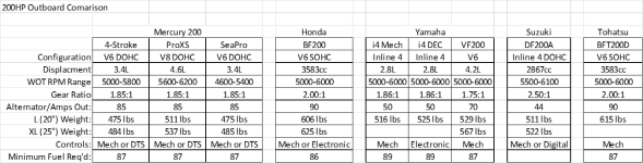

I would have gone to 200 hp, if I had repowered. Several have the 200 Yamaha 4 cyl and it works well. The Suzuki 140 (current model, is close to 140 hp, but the older ones were more like 130==and a 130 was underpowered on my first C Dory 25.
The 150-200 Suzuki is the same block (in 4 cyl), and weight is about the same.

If it were my boat and my money, I'd go with the 200. Same weight as the 150 and 175 and just a bit more $$$. This allows for when the boat is fully loaded for travel without compromise. It's not only a loaded boat to be concerned about with travel, it's also head wind and head seas.

The Suzuki's and Yamaha's 150 and 200 weight the same, as does the 150 Honda they are replacing: about 490 lbs. The Yamaha 100's are about 360 lbs: or 720 for the pair! No idea where Foggy got the weights of the motors he is suggesting. Perhaps he is confusing Kilograms for pounds???

The Suzuki 175 and 200hp have slightly more torque and would be a great option, I also like the Merc 200hp which has way more torque but the amount I saved with the demo 150hp will pay for 10 years of fuel!
