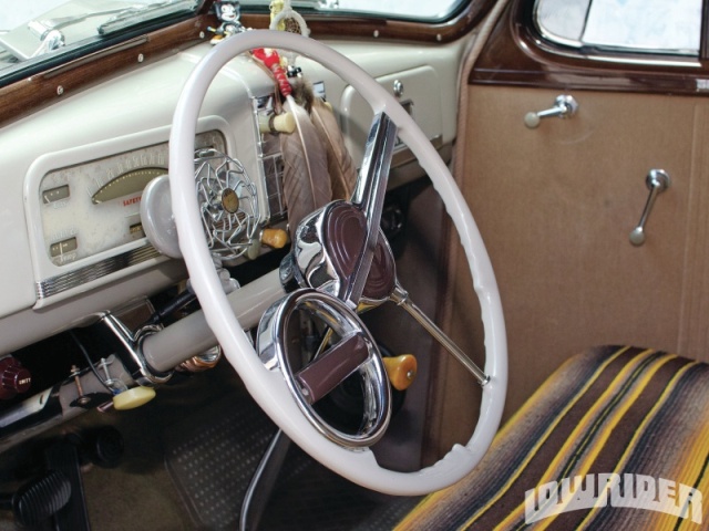

OR: You could get a 1940-something Buick steering wheel with a built-in spinner handle:
(Section on left of wheel center rotates within it's circle, allowing hand to turn wheel 360+ degrees without letting loose or turning over.) CLEVER!
I have also seen this steering sheel attributed to a 1938 Chevrolet!

Joe, Love that Buick wheel! I had never seen one.
