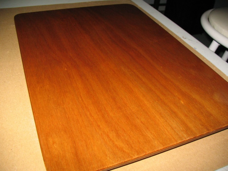

Board made utilizing some scraps to fill the hole from the Wallas (removed and sold). Just some scrap 1/8" ply epoxied together to make 1/4", then cut out, some cleats stuck to the bottom side, and then varnished.
