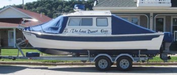

Colby just posted about not towing with his boat cover because of increased windage. I have kind of the opposite. It all started two years ago when I was heading to Lake Powell. I thought I might want some kind of a shade for the fore peak hatch. I had some Sunbrella left over from when I removed the stock V berth cushion. Then I thought that I could fashion something that would also protect the cabin window from bugs and rocks. Bugs are a hassle when I get to a launch site and have to spend the time and water to clean them off before launching. Rocks are a problem because I had heard of people hauling in to remote launches on Vancouver Island and finding that their windshield was cracked from gravel on the logging road.
As I worked on it a little, I also realized that a large cover from just the cowling to the bow would also work as a wind deflector. My cabin sits just high enough over my tow rig that I'm sure it works just like a parachute at 60 mph. I made it extra stout (although with used Sunbrella) and went off to Lake Powell.
I had kept track of my mpg while towing the boat for over 1,000 miles. Average was 20 mpg. With my wind deflector, I got 22 mpg down to Lake Powell. I was getting the same on the way back, but up by Moab I got into a wind storm. I slowed to 50, but the wind coming at me was also 50 mph. At an effective 100 mph, I tore up my little gizmo.
So I made a new one out of reinforced polyvinyl . It is a little bigger and wraps around the cabin a little better. I'm hoping for 23 mpg!! Of course, it cost me $50 to make, so I need to drive thousands of miles to make it pay for itself. Shouldn't be a problem. And of course, no more bug splatters to clean up.

Hopefully, I took that into account. On the finished cover (the picture was during the fitting stage), the grommets have a thick nylon webbing through them to keep them away from the gel coat if the cover flaps. The leading edge is forced down completely across the front lip of the cabin and should not flap. On my initial cover, I did have a black nylon strap that flapped against the cabin wall. It left a black smudge what was easily cleaned off. That told me that, as to nylon vs. gel coat, nylon is the sacrificial material. It's hard to see in the picture, but the cabin side to deck cleat connection has a foam net float at the top to work as a stand-off from the side of the cabin. This is where the original strap rubbed on my first smaller cover.
My tow vehicle is a Santa Fe Sport. It has a 2 liter 4 cylinder turbo. 264 hp and 269 ft lb torque when I need it. The trick is to not need it too much. If I pretend that the boat and trailer aren't behind me (which is easy to forget), I'm sure that I could think "Wheeee" and get 16 mpg. Mountain passes are not an issue. This model came with a factory #3,500 tow package.
The material is glued ala repairs on an inflatable. My sewing machine won't do this material, and my initial destructive testing of glued edges (no seams on the large panel) were impressive. On both sides of the GoLight are Dot fasteners to ensure that the center won't be pulled down. I haven't taken it for a road test yet. I'll get more pictures today.

I had used the 15 oz PVC in the past to make semi-clear dry bags for kayaking. It really helps to be able to see through a dry bag. After a few days, I can't remember what is in different color or size bags. I have started to use the thin coated-nylon dry bags that are so cheap on the CD 16, but they can't take any abuse. I put label tags on them.
The trim material is a combination of 10 and 18 oz. stuff from my old scraps. The glue, as one would expect, is some horribly toxic stuff. The material is scuffed with sandpaper and cleaned with Toluene before the glue is applied. This time, I used alcohol and it seemed to work fine. The glue is applied to both pieces, then stuck together, then rolled with a roller. I put down some heavy paper because I was working on a vinyl floor. If I had glued my project to the floor I would have been in trouble.

The rail seems perfectly placed for this connection. It can only slide up or down an inch or two and, on the previous one, the air pressure pushed down and they didn't move.
Seattle Fabric and Sailrite sell that special punch for the Common Sense fasteners. I didn't get it because I was only doing a few. But I did learn that whatever the fibers are in the vinyl, the grommet punch did not like them. I actually had to sharpen my grommet punch after doing a couple of holes. I'm not sure how easy it would be to sharpen the special $70 punch for the fasteners. I just used an EXacto knife for those.
