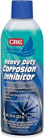

CRC 06026 Heavy Duty Corrosion Inhibitor, 10 Wt Oz
I sprayed my motors when I repowered two years ago. They still look brand new.
