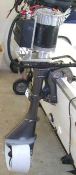

This is not my neighbor's, but one I found on the internet where a person has put a Scott 24v 1 hp electric motor on a 2 1/2 hp Nissan with the power head removed. In this case, the motor pushed a 12 foot fishing boat at 6 mph, and the Kort nozzle added 1/2 mph and decreased the current draw by 5 amps. Not practical for our uses.
