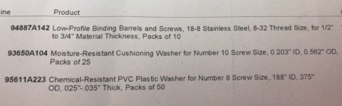

I ended up replacing all of my rivets with these SS barrel nuts from McMaster. It leaves a very clean finish inside of the cabin without having to add blobs of sealant or dealing with protruding nuts or bolts. So far, the little sealing washers have kept the inside of the boat leak-free. It's a bit expensive and requires two people to install, but I think it was worth it. The nylon washer on the outside keeps the aluminum and stainless separated, the soft washer on the inside keeps the hole sealed. I used a little blue Loctite in each one since they aren't torqued super high.

My rubrail is aluminum and the fasteners I used are stainless. This is generally not a great combination because these dissimilar metals cause galvanic corrosion in the presence of saltwater. I tried to address this by placing the small gray PVC washer (in the photos above) between the binding post and the rub-rail to isolate the two metals. I really wanted to find a clean solution without having nuts or treads or peeled rivets protruding on the inside of the hull since I use that area as a backrest in the berth. I was also in the process of re-painting my cabin and didn't want to have to add globs of adhesive over the inside rivets to seal them, that's what the soft cushioning washer is intended for. That led me to the binding post, and I could only find them in stainless. I think aluminum would have possibly been a better choice but so far, it's worked out well, no leaks and no failed fasteners. The only issue I have had is that some of the sealing washers inside the gunnels have turned yellow from the UV light.
