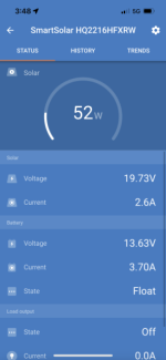

The controller works well with the Victron smart phone app. Looks like it's all working as it should.
So far I've been impressed. I've had the refrigerator going as I'm getting ready to head up to Isle Royale this week. Every day, an hour or two after sunrise, my battery is back up to 100%. It'll be interesting to see how it does with the freezer on board. Colby
