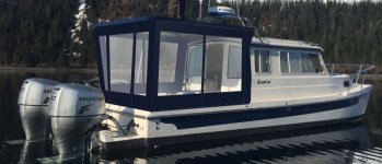

What material is the top made of? Nice looking!
Hi thataway - the roof is made out of 2 sheets of 1/2" plywood, it is sort of a prototype and the goal is to go to either aluminum or fiberglass but this year thought I would go with this, it turned out so nice though that it might last a few years before I upgrade :)
http://www.c-brats.com/albums/Sundog/top.sized.jpg
Here is picture of top

I had a hard top over a flying bridge made of what I suspect was "patio roof" material. It was aluminum sheets top and bottom and styrofoam 2" thick in the center. It had fiberglass all-around the edges, bonded to the aluminum top and bottom, with epoxy. It appears to still be going strong 17 years after I sold the boat (the boat was up for sale again, after doing the "Great Loop".
Probably the best is going to be a crowned roof molded of glass, with a foam core.
