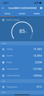

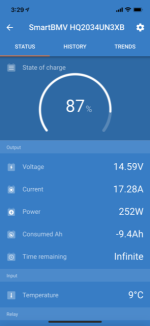

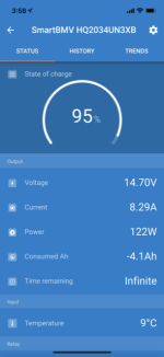

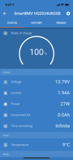

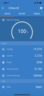

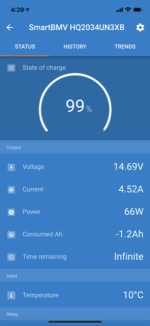

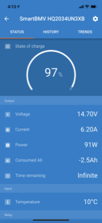

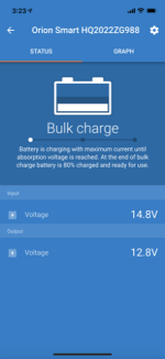

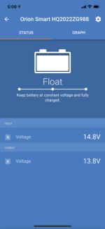

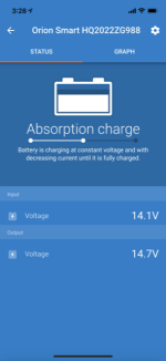

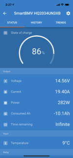

Well the charge coil is under a cast iron fly wheel, but if I stop the motor I should be able to get a temperature from the bottom. I went hunting for all my clamp on meters and there all AC. I do have a couple of shunts laying around and with the blue tooth dongle will give me more info faster by just being able to do a screen shot.
Normally my start battery wouldn't be discharged as it only starts the motor and is used for the bilge pump. I could see that it might be good information to know how things might react under those conditions so I think I'll give it a try.
I think your right about the battery buffering what is going on, the test should prove that or I'll have to switch to the 18 amp DC to DC charger.
