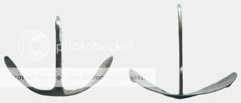

While this post appears to be spam and if it isn't I appoligize it is a interesting anchor design. Especially the breakdown model. Website gives all they deminsions and it would be easy to fab one up. Anybody ever see one of these. I've got a Fortress second anchor and it is more trouble to break down than I want to deal with so I generally leave the cumbersome thing assembled.
Yep - looks like a spammer - 3 posts only - all about his commercially available anchor.

Answering "Doryman” who is looking for a collapsible anchor?. Yes, I’m the manufacturer of this anchor, but by doing that I hope to help somebody who has a specific problem to solve.
This is not my conception of SPAMMING; Spamming for me will be if I will have posted a blatant advertising on all anchoring threads.
Yes too I’m an anchor designer and manufacturer, but believe me, I have more experience on this subject than most of you and I can talk (write) many useful info on this subject... without saying « my anchor is the best! »

Joao interesting looking anchor. Have you thought of maybe becoming a site sponsor. Typically when we see a first post with a link to a business first thing that comes to mind is someone is here just trying to sell his wares. If that isn't the case I appoligize. Maybe some of us are a little over protective of the site but we surely don't want to exclude anyone with a genuine interest in C-Dory's. At the sametime we don't want the site to become a big advertisement for Marine Products.
I don't see any scientific testing (as much as any anchor tests can be scientific)--with a lot of the web site "in construction".
There are a lot of similarity with the Spade anchor, and the Oceana anchor (now marketed as the "sword" by Spade. Also similar are two pulling angles--the Raya of 32 degrees (the magic number of Robert Danforth from the 1930's) and the 40 (45 in the Fortress) for mud...So this is certainly not a new idea. The variation of the weight, balance, and location of the shank is what separates the various anchors--and perhaps avoids patent infringements. Along with the taper or lack of taper of the roll of the fluke.
It is also similar to the Ronca and the Manson Supreme.
Is it spam? Don't know--but it would appear that the poster put the post here primarily to expose us to his anchor in three different threads...that smacks of Spam...but we all have different definations. He has also done minimal posts about his anchor on a number of other forums--as was done for Spade and Ronca anchors in the past...(we assume different developers).

The « game of similarity » is a very classical one with anchors! I agree « one anchor looks like an anchor » but in your list of similar anchors, you forget one:
If you are an anchor « expert », you may know that small differences can completely change the characteristics of an anchor. Generally speaking, « similar clones » give much worse results than originals.
The RAYA anchor is an improvement over existing anchors.
Compared to the Spade (and others) its efficient blade surface area, or let’s say the ratio Blade surface area/ total anchor weight, is much bigger ; 1400 sq cm for a 30 kg Spade versus 2000 sq cm for a 30 kg Raya. Or if you prefer more holding for the same weight or again the same efficiency for less weight on the bow...
Compared to the new generation of BSH*anchors (*Big Stupid Hoop) the RAYA doesn’t need the « roll bar » located at the worse part of the blade – the weight of this « roll Bar » reduce the weight at the anchor tip which is not a good thing for the anchor penetration (24% for the Supreme – 34 to 37% for the RAYA)
Similar?? Yes like a Chevrolet car is similar to a Toyota one, both have wheels and engine!
Please, stick with the anchors you own: Manson Supreme, Delta, Fortress, Danforth, and Northill....plus an old fisherman... on our side, we know that ALL characteristics of our new anchor are much better than the ones of all existing anchors.
